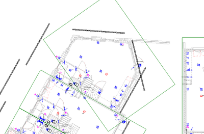

When i want to rotate scope box in a depended view is does not work. I think its rotating the 0-point. The view is going very far from the drawing but does not rotate itself.

BaridDulger70
When i rotate  the scopebox i see this, and that effect the view

BaridDulger70
That i see this view rotated

Is the rotated scope box assigned to the view?  I don't think so.
Message 11 of 17
BaridDulger70
Yes it is

BaridDulger70
then it opens the normal floor plan full, on a further place. When i rotate there the view region it turns, but when i assign the scope box again views a horizontal view
Message 16 of 17
BaridDulger70
my collegue has no problem with it. He can turn it how it needs to. But just by me it is not working
Message 17 of 17
Sounds to me like you are rotating the Crop Region of a Scope Boxed View. Don't do that. Pick one or the other to rotate.  If you want the View displayed per the Scope Box's rotation, then rotate the Scope Box which is represented as a green dashed line. The Scope Box will be visible in a View that has NO  Scope Box or Crop assigned to it.  If you rotate the Scope Box in one View, it rotates it in ALL Views.  Now, if you just want to rotate the View, independently of other Views, then set View's Scope Box to "none",  activate the View's Crop Boundary and rotate it. Don't assign a Scope Box in that View.
