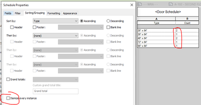

hmunsell
You already have the Count parameter added. All you should need to do UnCheck the Itemize Every Instance parameter at the bottom of the Sorting & Grouping tab.
