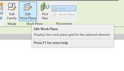

RDAOU
@ejowalter
No...and to align them to surfaces you need to either Edit Workplane or use 3D Snapping
