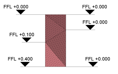

I'm wanting to apply a Model Fill Pattern to a Floor Slab with Modified Sub-Elements but finding that the pattern cannot be aligned (but it can be rotated) to the different edges. The result is a very messy-looking slab.
As a workaround we are thinking of using Filled Regions using the Floor's Boundaries but it just feels too time consuming.
Any ideas on a quick way of reorienting all the Fill Patterns to a desired orientation?

I would add split line. That way your pattern will be minimized to two varies instead of multiple pattern to rotate.

Thanks @syman2000 , but for my case I will need to keep the Modified Sub-Element edits on the floor slab so adding split lines and modifying it is not an option.
