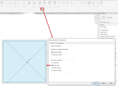

When I define a room as a space, it follows the bounding walls to the exterior. But when I assign the room to a department, the room boundaries are changed to the middle of the wall.
Does anyone know why this happens and how I can change it to follow the wall boundaries even with departments?
EDIT: The area calculation is on point as it is calculating them as the exterior is bounding. It seems to be a visual glitch.

Hi @timo_hiitolaSD3AY
My guess is that you are using a color scheme in foreground:

Thank you for the replies. I've tried both of your suggestions. Unfortunately, I have the color scheme location in the background, and the room area computation is at the wall finish.

Is your view set to wireframe or have filter set the wall transparent?
timo_hiitolaSD3AY
Yes, I had my walls at 80% transparency. This was because I was doing a model out of a point cloud.
Thank you for the help and fix.
