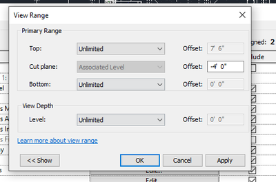

These are the view range settings. I'm not following why the roof is not showing up here when I have the top level set to unlimited. I mean that's higher than 30'-0" above the Associated level in the 1st example AND it's the same associated level. I have also created and experimented with another level called "roof high elevation" which is the highest point of the roof. The negative 4'-0" is showing the cut through the clerestory.... but the original version is also the cut through the clerestory and the offset is 30'-0" so I'm guessing the cut plane doesn't really matter because it is all dashed below..... so bottom level and view depth level are really probably determining this.

A roof plan that is created from the first floor level would need to have its view range adjusted so the Top and Cut Plane values in View Range are high enough that neither intersect with any building elements. The Top Plate level could also suffice to create a roof plan view IF its view range settings are also adjusted in the same way. That means "any" level could be used to create a view that is called "Roof Plan" as long as its view range is adjusted accordingly.

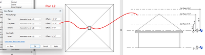

One reply to address view range Cut Plane settings - have a look at this series of images changing the cut plane value for L2 relative to the roof.
The reason we need to move Cut Plane "up" is to make sure it does not slice through any part of the building to create the view. Cut Plane can be equal to Top but it cannot be higher than Top. Each View Range boundary can move up/down but they can't pass one another.
Revit uses projection and cut object style settings for elements that exist within the Primary Range (Bottom-Cut-Top). It use the line style <Beyond> for any elements found within the View Depth (View Upth for Ceiling Plans). Imagine a two story building with a balcony for the second floor that overlooks the first floor. In a second floor view with the default View Range settings you won't see the first floor elements that would be visible to us if we were standing on the balcony. The View Range View Depth would need to be changed to the Level Below or offset by a value large enough (negative number) so that View Depth is far enough "down" that elements on the first floor would be included in View Range and visible in the view.
Same is true in reverse for a ceiling plan looking up at the roof/atrium space in a tall building.
