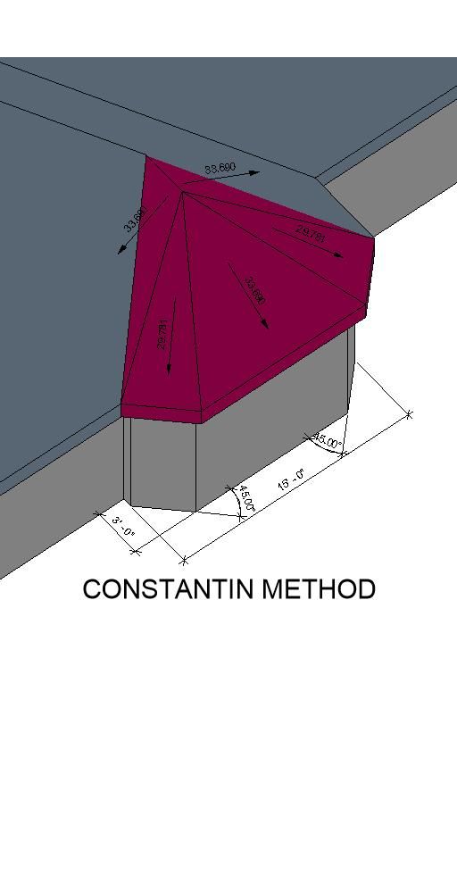

constantin.stroescu
Well...., in a more general case, when the sides of the bay are unequal and the angles between the two neighbor sides and the edge ( from there common point to the peak) are unequal ..meaning unequal slopes too ...something like this:
then,  a simple geometric construction will do the work -
( at the beggining ,I thought , it could be done using a combination of Slopes with Slope Arrow tool, but it didn't work..)
Constantin Stroescu

Mind if I jump in and join the discussion?
I tried the same darn thing last night, @constantin.stroescu, but I couldn't make it work. Now it works!!!  Go figure. Thanks for coming back with this the "goods" and proving my assumptions wrong. I love it! Good job! Thank you.
edit...knowing both approaches; which would you choose? I'm kind of favoring the shape surface method myself.  Easier cleanup, IMO.
Message 16 of 19
Yep, works like a charm. Abracadabra, no shape editing:
