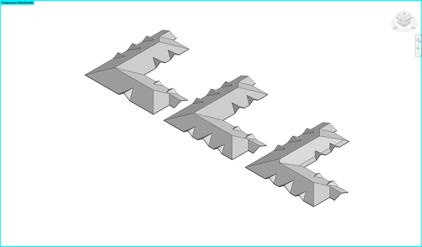

Everyone,
For some unknown reason my roof is changing from a 5/12" slope to a 9/12" slope mid way. I have a complicated roof with dormers and if I eliminate the dormer, the roof model's without issue. Also the eave height has raised at the corner. Any suggestions? I've post a 3D view and how I have it modeled. I'm only defying the slope on the southeast corner (see below)
If I define the slope between the dormers, the eaves are all the same height but I have the weight transisiton from 5/12 slope to 9/12 slope mid-roof.
Any help would be greatly appreciated. I'm going nuts.
Meg

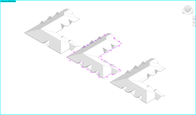

Looks like you broke the rules, so to speak, and Revit worked out a configuration based on the input.  Red circles should be defined slopes.  Blue circle is Revit's brain on drugs. I'm surprised Revit didn't throw a hissy fit upon finishing and closing out of sketch mode. You got lucky.
Attached is one solution, doing the two smaller eyebrows as separate roofs.

Here is a single roof without the wacky feature.  What you did wrong was splitting the sketch of each dormer into 2.  You don't need to that.  Each dormer should be one segment with 2 sloped arrows of the exact same length.  SO draw the arrow from one end to the mid point of the segment, then mirror it.
See revised file.
Message 17 of 20
in reply to: ToanDN
So, what you are saying is that I and the OP got lucky doing 10 eyebrow using a split boundary line?  FWIW: It's been documented both ways.
Also FWIW, here's a screenshot of your roof which I revised to add the 2 eyebrows you missed and to change the slopes to match the ones the OP used.
Weird, huh?
