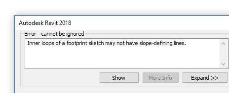

I'm working in Revit 2018.3. I don't understand my issue in the slightest. I tried creating a roof, from foot print, and I kept deleting lines til it would create. I literally can not get a roof to create with more than 6 sides. Is there something wrong with build of Revit? I've attached a snippet of a roof shape that errors out.

What sort of roof are you hoping to make? Right now you've got all the segments as Defines Slope (small triangle symbol indicates slope). If you want a flat roof then each segment should not have Defines Slope checked. The plan of the building does not suggest you'll be able to slope every eave of a roof, the notches and bays don't look like they've been conceived of with a sloped roof in mind.

The attached roof design isn't anywhere close to where it needs to be. But my initial footprint kept giving me errors, so I kept deleting parts til it didn't give me an error. I got down to a 6 sided roof before it didn't error. The attached image was an example of what should be a simple 4 sided hip roof with a hip bump out, yet even such a simple design is throwing errors.

This roof also has opening in the middle, not cut openings, but sloped openings. I'm getting notices now that I can't have interior lines that have a slope?? So how do I create a roof like I have modeled using a sweep.

By Footprint you'd need two roofs. The issue is the interior boundary. Revit doesn't like that condition. They can meet at a corner but you need to break the roof so they aren't a closed loop.

ugh.. Having to do that work around is surely going to cause even more issues haha. I was able to make a more complex roof by drawing the lines and not selecting lines. So thank you for that.
Message 11 of 33
constantin.stroescu
as Steve said it can be done using a join of two roofs
Attached a screencast that is similar to your task....
