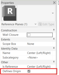

 Hello, i have a problem window family is being selected from blue point, outside geometry of window, how can i fix this i have attached family file, thanks 🙂

Everything looks ok. Both your "origin" reference planes are defining origin:
Also, i tested the family and it's working.

Hello, problem appears when i load the family in project.Cursor is way off the window geometry and its being selected

The problem seems to be, that your reference planes extend about 1.5m outside of the wall:
Unfortunately I dont know how to "shorten" them but you could always set them to "not a reference" and they will disappear in the model:
