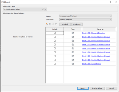

Looking to know if a revit model/ revit file can be exported to AutoCad or can revit only export selected views or elevations etc

Yes it is possible, have a 3D View open, then Export to CAD
How to export a model to dwg as 3D solid in Revit (autodesk.com)
You can Choose what you want to Export

And just another thing on that. does this also export the sheet templates with it and if not how can I go about exporting a sheet template from revit to AutoCad
jay_colcombe
Yes it does if selected

@D23124962 wrote:
does this also export the sheet templates with it ...
What do you mean by "Sheet Templates"? Revit will export your sheet view as @jay_colcombe showed, with or without bound reference files (I recommend without if at all possible 😊). Revit will not export a "Template" DWT file though.

I meant the sheets which Jay demonstrated there
HVAC-Novice
Even better solution: give the person still using AutoCAD the rvt file and let them extract what exactly they need. that way you are not pre-selecting what will be included in the dwg, and you don't have the work 🙂
