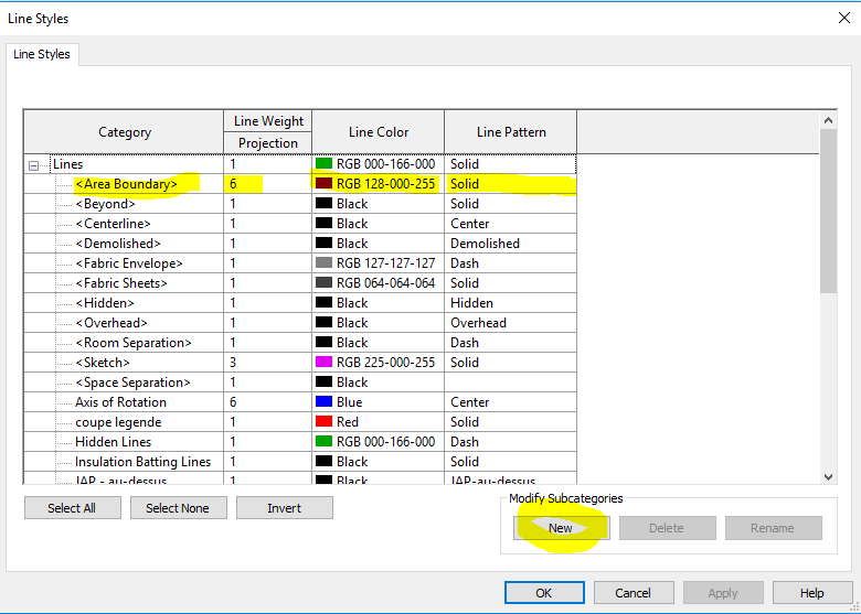

Hi @julian_seymour,
What you need to look at is how line styles work, from one family to the project.
First, let's have a look at what makes a line style:
A line STYLE is made of:
  1. A line Weight
  2. A line Pattern
  3. A color
Line weights change according to scale / type (annotations are always 1:1):
And in the line styles you set your weights:
OK, that is for the basics.
Now you know how to create a new line style in your Title block.
Here is the issue.
When you create a line style in your title block and you load your family into your project, Revit CREATES a line style that corresponds into your project.
If you LOAD YOUR FAMILY AGAIN, Revit will not create the line style again.
It will override the one in your family.
So, it explains two things:
  1. changing you line style in your family once it has been created in your project WILL NOT UPDATE THE LINE STYLE IN YOUR PROJECT
  2. when editing your titleblock/family, displays will differ as LINE STYLES ARE NOT SYNCHRONISED.
So, DO NOT PANICK IF DISPLAYS DIFFER, they will get back to normal once the family is reloaded into the project
And Change the line styles IN YOUR PROJECT for printing, and SINC them BY HAND if you want them to display the same!
