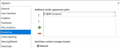

One way to overcome this would be to add texture to a specific folder in your local drive. I know it won't work for all scenario, but it is better than remap the texture. I agree Revit should embed texture into the file itself much like how Sketchup does for their texture.

Also I've use one drive and create a folder for the texture. Afterward I use shared functionality and send it to your colleague. From their end, they would accept that invitation and have direct access to the folder you shared. Once you update the texture, it will sync to your colleague folder. All the colleague need to do from their end is to map Revit path to that specific folder. If you give them access to write to that folder, they can also add texture and it will sync back to your folder.

The following article has information on this topic: Sharing material appearances with other Revit users
Some important points from the article:
  • If you are working in Revit 2020 or 2021, make sure Revit is updated, to avoid this issue (where additional render appearance paths don’t work).
  • If you would like to see material textures embedded in the Revit project file (in future versions), please vote up this idea: Embed Material Textures
