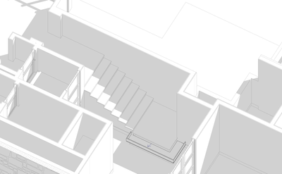

Mirror the stair run.
Nachricht 10 von 20
sgreenEG3XN
als Antwort auf: ToanDN
I tried that. Mirroring the stair run line has no effect on the direction of the stair. Here's a picture of the stair. If I don't break the bottom two risers(single tread) out into it's own stair there appears to be no way to flip its direction without flipping the direction of the entire stair.
Because when I custom sketch it as a run within the main stair it flips the direction of it. And it was fine until I tried to add a riser line at the red line to make a it a "3-sided" riser. That's when it flips the direction of the run for no apparent reason.
Mirror the entire STAIR RUN after you finished sketching it, not its LINES when you are sketching it.

Before mirroring stair run.
After mirroring stair run
What looks like when I'm editing the sketch to get it to look correct. The circled area is the part that screws up the stair run. For some reason when I make that circled riser line a riser line instead of a border line, the stair direction flips.
After editing stair sketch to be correct, stair direction flips again for no apparent reason. I didn't even touch the stair path line.

sgreenEG3XN
And it can't be an issue with how I'm sketching the stair because it looks correct after I flip the stair direction.
But it's ridiculous that there isn't a way to flip the direction of one run at this point without making the run its own stair.

als Antwort auf: sgreenEG3XN
Copy paste the stair to a new file and share it here.
Like this?
Essentially. What did you do to get it to work?
Copied the run from one stair and pasted it in the other.

sgreenEG3XN
lol well I feel like an idiot. I didn't even think about doing that.
