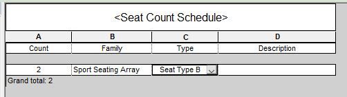

I'll try my best to map out my situation and hopefully it'll make sense to someone.
Basically - I'm looking for some help showing the number of objects contained in an array in a schedule, and not the number of arrays.
1. I made a line-based family that contains an object on an array. There are some basic parameters inside the family that automate how many instances of the object appear depending on how long the line is. (Picture 1 below)
2. I load this family into a project, draw a line, and it generates the correct number of objects in the array. (Picture 2 below)
3. I want to create a schedule that tells me how many of the objects are in the project, but I can only seem to display the number of array families in the project - not the number of objects that are being arrayed. (Picture 3 below)
Thanks!

Alfredo_Medina
Welcome to the forum.
Make the array with a family, and make that nested family (the chair) as shared.
Message 6 of 19
That's exactly what I needed, Alfredo!

Can you explain what you mean by making the chair family as "shared"?     In my revit model (attached), there is a family called "auditorium seat" which is part of a parametrically controlled array.   After loading int the main project and placing and adjusting, I want to count the [a] "auditorium seats" not [b] the family that arrays them which is called "12-Auditorium Seating".    [b] is the only thing I can seem to create a schedule for, not for the [a] "auditorium seats"  family with them.
I see that there was a solution here, but am not following the explanation.    Tell me what I'm missing.

You need to make the nested Auditorium Seat family nested, not the host Array family.
Message 19 of 19
steve
Thank you, that solves it.
As a note to self: open the nested family (the chair itself) separately, change to "shared", reinsert into the host family (the array), then re-insert that into the project.
