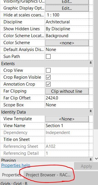

I note that you state that this is not a User Interface issue, So I assume that means that under User Interface, Project Browser is Ticked on, as below;
Next can you confirm that the Properties palette and Project browser are not Tabbed?
if they are tabbed, you will see a tab at the bottom of the Properties Palette as per the below;

Hi There;
I appreciate the reply. The browser was actually tabbed.
Sharon
@Anonymous wrote:
Hi There;
Sharon
So it was a user interface issue....or between the keyboard and monitor.  (hide)
