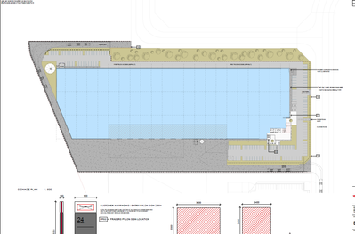

Hi the issue is, when in the model space & in sheet the colour line weight is very good just like what i want but when i print to pdf the quality drops line-weight doesn't match. I have attached previous example.

Check the view with the "Thin Lines tool" enabled to see real thickness of the lines
