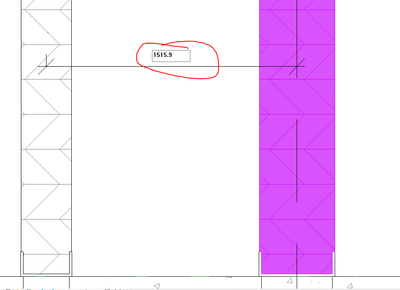

Mike.FORM
also for a single segment dimension you can see the actual value in the properties.
Here my dimension shows 1516mm but in properties it is actual 1515.9mm.
You can also see the actual value by first selecting the item the dimension is referencing and the clicking into the dimension value. This will work on a dimension strings.
