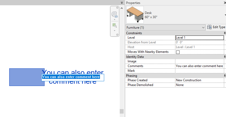

Hello, I was tasked with creating a custom tag that has a default "comment" parameter or any parameter I create, but what they are asking for is an instance based tag that you can fill in the tag value and it fill in the comments parameter and being able schedule  out the family as opposed to a generic text with a leader. I'm not even sure if its even possible but any help would be greatly appreciated. Thank you in advance.

Sorry, I am looking to create a tag that isn't already defined. I want the tag to be empty and have the user click and edit the value in the tag and it update the family instance parameter.
Message 4 of 10
Create from a Multi-Category Tag and use "Comments" for Label.  Then in the Project, write in the Comments you want the Tag to report directly into the Tagged Elements' "Comments" Parameter Fields.
Message 7 of 10
Jes_Gonzalez
Worked perfectly!
