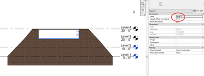

My topograph is reaching upto Basement 1 and not Basement 3
how do you fix this issue?
Also topo is invading the interior space of basement 1,2,3
I used "building pad" to cut the topo out for the basements. but they are working only for basement 1 as well

To edit the depth of the Topography go to the Massing and Site Tab and click the small arrow hilighted below to edit the Poche Base.
Can you check that your Topo is created in Existing Phaase, and the Building Pad is Created in New Construction.  Cheers

Building Pad is created in whatever Phase you create it in.  Did you create a Graded Region copy from Existing Phase Topo?  If so, then I could see how you might get it placed in the wrong phase?  I'm thinking the issue is more with your sketch boundary though.  Did you error out trying to draw the second Building Pad?
...FWIW: You can change the BP's Height Offset From Level to raise or lower the Pad.

Hi Joe
Thanks for this! it solved the depth for the topo!
But I am still not cutting the basement level 3. I did click existing topo and clicked "Graded region"
I did the same for Basement 2 topo "Graded region"
But for Basement Level 2 topo is still covering the basement level 3. (See images attached)
What can I do to cut out topo building pada basement level 2 so basement level 3 is shown on the section?

Can I jump back in here? I'm a little confused about what you are describing. Are you talking about Building Pads or Toposurface Poche in Section View or Graded Region?  They're all quite different things.
...have you tried to  change the BP's "Height Offset From Level" that I mentioned before?

I think I get it now, @katherineyoonn.  The information in the first part of this Screencast may help you resolve your issue.  If you are Phasing Building Pads, the whole Screencast may be worth watching.

Amazing thank you!!!!!!
I realized rather than covering the entire basement 2 floor with PAD 1, and I separated one PAD1 (#2,3 see attached)to two.
That allowed me to create PAD 2 for basement 3 (#1)
