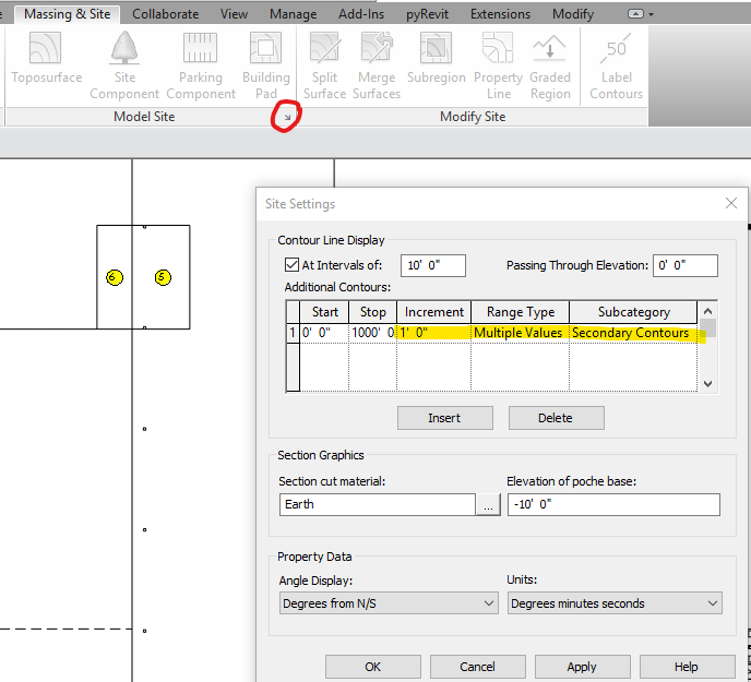

Have you reviewed the Site Settings dialog and made adjustments there yet? Look on the Massing & Site ribbon > Model Site panel > small arrow pointing down at 5 O'clock.

See below:

It doesn't look like there is any relief for miles and miles from the Project site.  Is this a Toposurface from CAD Import?  Did you import it in at the correct scale?
