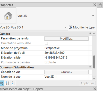

when i create a new 3D view , the model ( now just grid and linked CAO) are not showed
i thing the camera is set in a far place ,
i have those number on the camera setting ; i thing someting wrong with them
i tryed to create a floor and creat a camera in it direction ; it work at first , but after some mouvement the camera is lost ; and the eye elevation and target elevation are showing those rediculus number
any idea please

The origin point (internal origin) is too far ... or the CAD links (or other elements\links) have UFO objects flying around far away from the building.
If you can share the model, I can review it.

I think that it's the second option; the linked cad have ufo object far away the building; because every time I try to link a cad for a new level I got this issue
how can I solve this
Basam.Yousif
These numbers indicate the possibility of the internal origin point bring too far away.
Does this happen all the time? even before you bring in the CAD? You might need to clean up the CAD first before you bring it in. Simply copy\paste everything into a new file.
