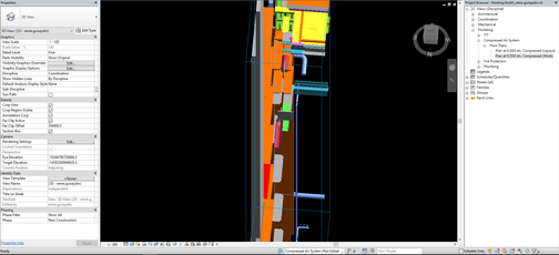

Dear Sirs,
I am working  MEp plans on the revit 2017. and when ı open 3D plan, view is seen like as below picture. all lines are mixed and ı dont understand coordination. maybe solution is very basic but I cant solved. Could you please help me about this problem.
Not: I tried all detail level and visiual style.
Best regards.
719 Views
ennujozlagam
hello, try to untick use hardware acceleration from options and delete the 3D view and create a new one, and see if helps. thanks
hello,
thank you, problem is solved.
