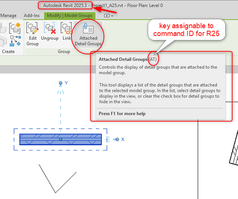

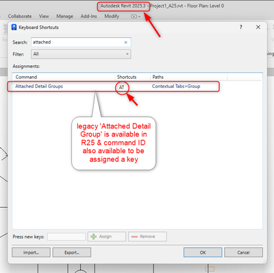

Remember, tool still exist in Revit up the whole life cycle but then tool suddenly can't be assigned a shortcut key, which is little strange & not helpful with mass who uses such tool.
As for Revit 2025, no issue as key can be assigned as below

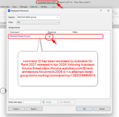

Thank you again for following this through, and I would like to update this thread following some test on Revit 2027.0.1 released in Apr 2026.
It is found that the command ID for 'Attached Detail Groups' has been reinstated for Revit 2027 by Autodesk.
Revit 2027
CommandName:      Attached Detail Groups
CommandID:            ID_EDIT_GROUP_ATTACH_DETAIL

Previously 2025 - 2014
CommandID:            Dialog_ElementGroup_EditGroupNew:Control_ElementGroup_EditGroupAttachDetail
Path:                          Contextual Tabs>Group
