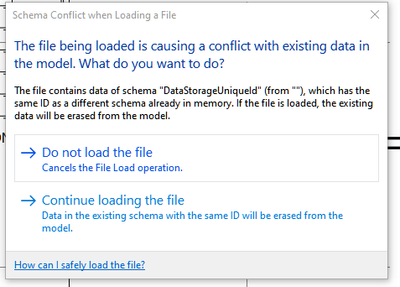

Since upgrading to 2024.1, I constantly get the following error:
"Schema Conflict when Loading a File"
Is there a fix for this?
Message 6 of 50
RobDraw
I've seen a similar error from an add-in. We don't use the schema, so we let it load. If you use the schema, you'll have to figure out the best course of action.

A couple of us in our office are also getting this exact error this morning. I updated to 2024.1 on Friday at the end of the day, and was unable to open the file this morning. My colleague had the same error, but hadn't yet updated to 2024.1. We installed the update on hers, and were able to open it shortly thereafter. After a few hours of working, she got the same error when trying to synchronize. In all cases, choosing to continue loading the file just crashes Revit. I am still able to work, for now at least.
The model is hosted in Autodesk Docs as a cloud model. No Revit links, just a couple of DWGs. The Structural consultants has access to the model but is not in it, as far as I'm aware. We're not using any add-ins.
This seems like a bug. Unfortunately, it's completely stopping my colleague from working on this project. I've already looked at the previous solutions to this issue in past releases, but nothing seems applicable. Is Autodesk working on a hotfix?

@DanChristian , @HVAC-Novice , @GlynnisVP : I spent about an hour on a call with an Autodesk support agent, Lance. He was extremely helpful and we went through a bunch of possible solutions. Ultimately, the error seems to have gone away, so here's what we did in case it works for anyone else:
  • If someone can open the model, go into the Purge Unused dialogue and get rid of any unused Extensible Storage Schemas. In our case, there were two.
  • Synchronize and close the model.
  • Open and audit the model, sync it and close again.
This did not immediately solve our issue, but for some reason after about fifteen minutes my colleague was again able to open the model without the error popping up. It has also disappeared for me, and Lance (who I had added to the project to replicate the issue).
This is all anecdotal, but I'm not going to look the gift horse in the mouth. If anyone else is having the same issue, try running through these steps. If it doesn't work, let me know and I'll try to think of any other random things we did that may have fixed it.
Lance is also looking into it on his end, so hopefully we'll have some more clarity soon.

I hadn't heard of schemas before getting this error either. As I understand it, when you load an add-in (this includes built-in ones, like eTransmit, Batch Print, Formit Converter, etc.), it creates a "schema" within the model that defines the configurations for that add-in. It generates this schema upon first load, and gives it some gibberish name. This specific error is coming up because the same name is being applied to different add-ins for some reason, which confuses the program. Normally telling it to continue would just overwrite the schema with the current one, but this was causing crashes. Someone who knows the program deeper than I do can correct me on any of that, of course.
I suspect this error has something to do with an API change in the update. I've been using Revit for about a decade and never had this happen, so I don't think it's a common thing you need to be proactive about.

These schema conflicts are occurring in most cases when opening more than one model in a Revit session and there is a duplicate definition for the schema already in memory. These troubleshooting topics all give basically the same solution of just opening one model at a time in a single session of Revit.

Can the comments about the Schema warning be broken out to another thread? Someone can link to it as a separate discussion. Just a suggestion as I am following this closely.
At this point, I would like to add that I have experienced this issue in Revit 2022. As recently as within the last couple months. It could be happening as people are getting updated. (We don't always all do it at the same time.) It just hadn't occurred to me at the time. My research revealed that it was definitely related to add-ins. The information in the error message (as illustrated below) before indicates the source of the schema, which is one of the add-ins we use. I too, had to research schemas and came to the conclusion that we weren't using it.
When I consider it could be related to Revit updates, it does make sense. I know it's not happening when the add-ins get updated. I plan on asking everyone to let me know the next time they see the message. When it happens, I should be able to confirm if it's an add-in or a Revit update.
Another working theory is that the conflicting schema is in a link.
@loboarch,
Does Revit generate Schemas?
If so, can you check to see if the source of the schema in the above message is Revit or, as suggested above, different add-ins generating schemas with the same ID?
