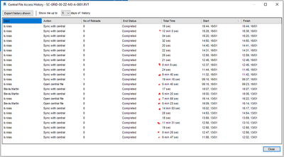

One particular model has been suffering from extremely slow file operations when it comes to the local file, but great performance when syncronising.
This is demonstrated in the below - items marked with a red dot have the "save local before and after synchronizing" box ticked, and average at 7-8 minutes per sync. When syncing only, performace is greatly improved, and is generally less than 30 seconds.
Creating a new local file has a simularly poor performance, taking around 10 mins.
RVT. etc extensions have been added as exhemptions to our antivirus, to no improvement.
Any thoughts on improving performance would be greatly apprecaited.
