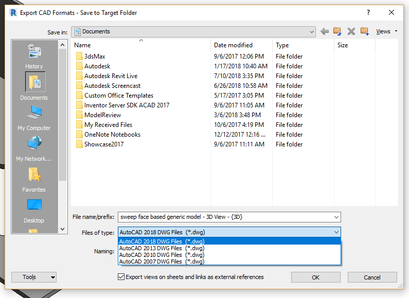

Is there anyway to export a Revit 2018 model to a version that is able to be opened in AutoCAD 2017?
Is there a hidden export version setting somewhere that I'm not finding?
Thanks in advance for any ideas.
Michele

When you export the DWG's click the properties button (...) and go to the General Tab and change the format to "Autocad 2013 Format"....as 2017 cannot open 2018 dwg's.
Thank you for answering my question,
"Is there a hidden export version setting somewhere that I'm not finding?"
I found the "Export to file format drop down" in a slightly different location:
File>Export>Options>Export Setups DWG/DXF>General Tab

Viveka_CD
Hi @mmcintosh-ral
Thanks for posting on the forums!
Please see AKN article to Export to DWG or DXF
If you find posts have solved your problem, please click on 'Accept as solution' to help others with similar questions.
Regards,
Message 7 of 11
Yep...my method saves it in the settings.  @Viveka_CD's has to be changed each time you save.
