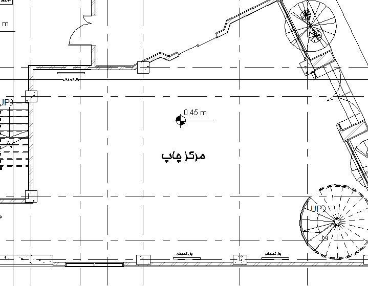

I write the text with size of 7 mm in revit 2016 and open file in revit 2017 text Appears is biger The same size 7mm.

Correct, but not a bug. They have changed how revit renders text in Revit 2017. This was apparently done to more closely resemble how Autocad renders text. HERE in the help file more information about the situation.
