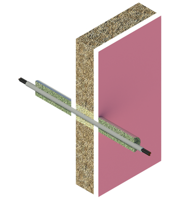

Hi All,
Does anyone know if there is a way I can render to show edges of my model as black lines similar to what you see in realistic view. As you can see, the rendered image below has no edge lines whatsoever.
I look forward to hearing from you all
Thank you

Many thanks for the video👍. Meanwhile, what I actually meant was to show these edges after you perform a render (RR) and not in a realistic view.
Is it possible? if so, are you able to send me another brief video for demonstration?

As far as I know, not without post editing. meaning
  1. Render the view and export the image
  2. Switch to Hidden lines
    • hide surface patterns to show only the edges
    • Export to DWG/DXF
    • Open in Adobe Illustrator (If you have no license you can use Autocad)
    • Export the vector 3D drawing to .eps
  3. Open the rendered image in Adobe Photoshop and overlay the EPS file from step 2
OR...Render in a 3rd party app that allow sketchy lines or edges in rendering
