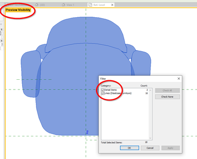

Steelcase turned off the visibility of the model elements and replaced them with lines and masking regions.

The visibility of the 3D objects is turned off. You will have to edit each family, by deleting the masking region then turn display back on for the 3D object.

The issue you're seeing in Realistic View — where some furniture components appear white or show flooring materials underneath — is likely due to Masking Regions used within the family environment of those components.
Many families (especially from Steelcase or other manufacturers) include 2D Masking Regions in their plan views, which override material visibility in Realistic mode when viewed from above.
📽Check the attached video for a quick demonstration of how this works and how to adjust it.
Quick Fix:
  1. Open the family in the Family Editor
  2. Go to the Ref. Level (Plan) view
  3. Select and delete the Masking Region, or replace it with a transparent symbolic line if needed
  4. Reload the family into your project
This should allow the material to render properly in Realistic View.

Not the material. The solid objects are hidden in a Plan view and replaced with 2D lines and masking region. I'm suggesting you fix this by editing each family, delete the 2D cheats, then restore visibility to 3D objects in plan view.

Edit the family. In plan view, delete the lines and masking regions. In 3D view, turn object visibility-in-plan-view back on.
