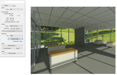

Hello!
I am having an issue with the mirror material, it will not reflect the image that I have for the outside. Can someone help please? Here is a picture to help visualize the problem.

lea.casagrande
The mirror is not reflecting the outside. I used this picture for the outisde and I would like to see it in the mirrors as well. Tree Benefits - 02.jpg

lea.casagrande
 Can you see the problems with the mirror on the right wall? They do not reflect the outside. Could you help me?
What it the image it won't reflect?  A Decal?  Try a PNG.
Message 7 of 13
You mean Planting RPCs. Check Cast Reflections under the Type Properties of the Trees.

lea.casagrande
It's not a decal, its a background image for my rendering.
Its a JPEG. Changing it to PNG did not make a difference, it will still not reflect in the mirror.
Message 9 of 13
Fake the background with a panoramic decal.

Message 11 of 13
lea.casagrande
This seems to be the solution! I'm not sure how to create a panoramic decal though, could you give me some steps? Thank you so much!
Message 12 of 13
Model a curved wall, create a decal type from the image, place it on the wall and stretch it.  You will need to play with the size and location of the curved wall based on your camera angle.

lea.casagrande
Thank you! It worked 🙂
