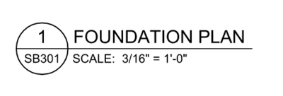

Hi all,
There is still an issue for Autodesk troubleshooting with this topic (see link: https://knowledge.autodesk.com/support/revit/).
If the problem you're facing is having wrong reference on floor plans / structural plans as shown below, then there is a walkaround which will be explained below:
Here is a snapshot of foundation plan referencing to SB301 which is a section sheet when it should be referencing SS101 which is the site plan
If that's the problem you're having then here is the solution:
  1. Go to the referenced sheet (SB301 in my example above)
  2. Activate every section on this sheet:
    1. Go to Visibility/Graphics window
    2. Hide Floors (Model Categories)
    3. Hide level (Annotation Categories)
    4. Click Apply
    5. Show Floors (Model Categories)
  3. Click Ok
After you have done this to every section on SB301 the reference should be updated correctly.
Please let me know if you have any questions.
Eli.

eli.fligelman
Hello ToanDN,
Thank you for your reply.
I do want to show the reference sheet, not the sheet number, let me explain
by this example:
1. Site plan is sheet A has a callout to a plan view to sheet B
2. Sheet B has section to sheet C, but the title of the plan view on sheet
B showing reference sheet number C instead of A
I do want to see the reference sheet on sheet B but somehow it shows
reference to sheet C which doesn’t make sense.
The workaround I wrote in my post shows that on the section on sheet C if I
hide the floors and level and then show the floor somehow this reference on
sheet B is shown correctly.
And if I show the levels again the reference is incorrect again.
I would appreciate to have a fix to this.
Eli.

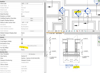

salman_afsari_6LYYGTFMHY26
I have almost the same issue with sections tittle. Some of my section tittle Won't show the sheet reference. They all have the same template but some show and other not. even though they are referencing the same sheet. Anybody has solution to this?
Message 16 of 16
Solved it, the view extend needed to be on specific distance. when I change it from 4'-0" to 2'-6" the tittle showed up.
