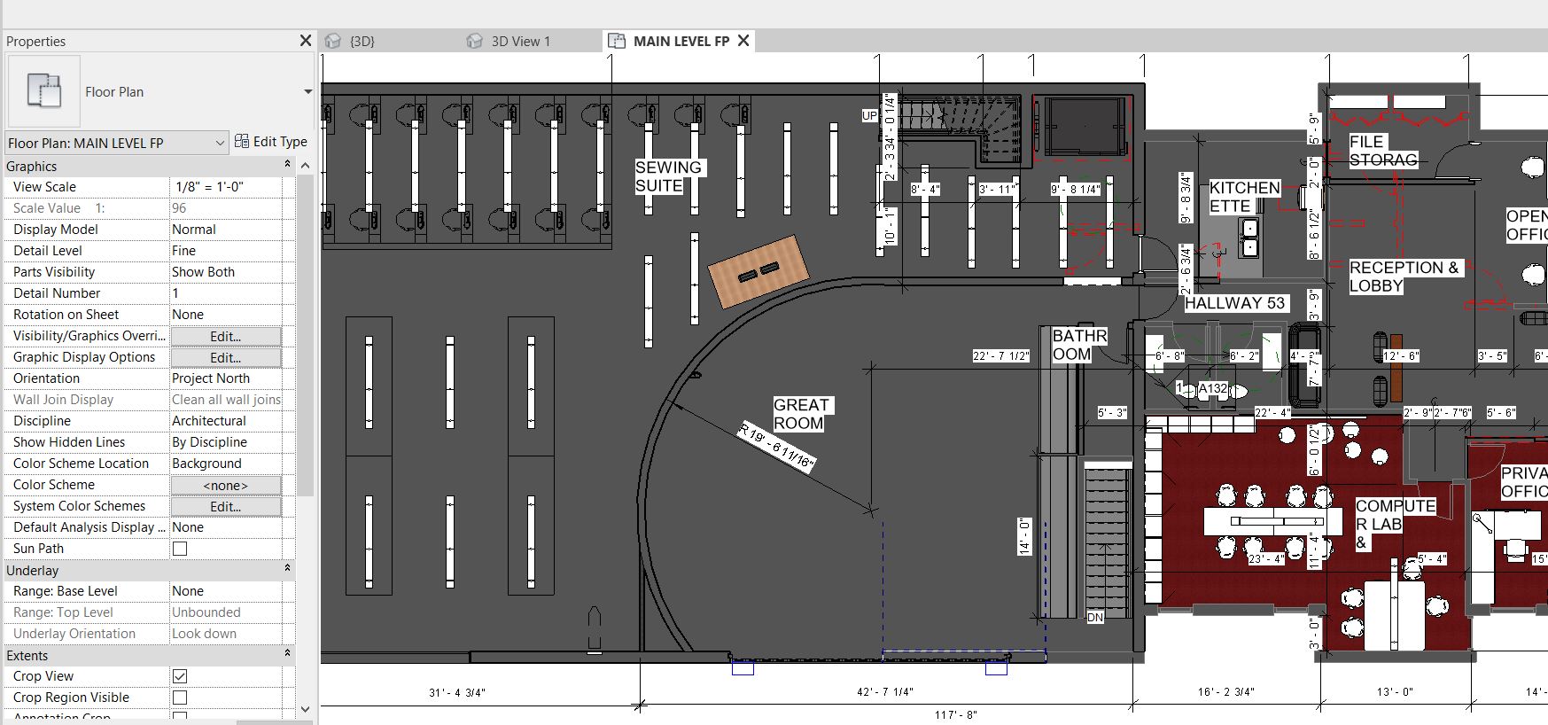

Most of my materials do not show. I can create a new one, apply it, and then it disappears into gray when I change the view. My Revit standard library does not appear in realistic view either and the materials library all have an orange ! in them.

-I will edit a family by applying a new material I created. It looks fine in the family and when I place it into the model. When I save and re-open the file, all materials are gone. Walls are gray with no materials showing. Floors are the same. I need to get this fixed. DYING...

Shows up gray in what View and Visual Style? What are the Material's Graphic and Appearance settings?  You see, there's a lot of questions needed answered in order to "troubleshoot" -- or determine if there is a trouble to be shot.
Message 9 of 30
Can you be more specific on what visibility settings you need? In the Visibility/Graphic Overrides drop down, the walls are selected to show, but they are gray.
Message 10 of 30
I'm confused by what you are showing in your screenshots.  I thought this about the Material Library not working. The Material Library is accessed and managed via Materials on the Manage Tab -- not through the Views' Visibility/Graphics Overrides.
Message 11 of 30
I thought you asked about the visibility settings in the last post
Message 12 of 30
Yes, it is. I'm trying to cover all bases here so we can come to a resolution. Attached are the ceiling details in the material browser settings for 24x48 ceiling tiles as an example. What do I need to change to get the visibility? I have never had to add "use rendered appearance" in a pre-loaded material before. Same for walls and flooring. Regardless, some floors show, some walls do too. Other walls, ceilings, furnishings, etc do not.

I know I'm jumping in without understanding the whole problem here, but could the issue simply be one of the view settings?  When you are using Phases, if the view parameter called Phase Filter is set to 'Show Previous', the elements created in the Existing phase will show up gray.  One of the snips had the view settings set to 'Show All'  which will normally cause the behavior described.
The red floor that was shown was probably modeled in a New Construction Phase which is why they show correctly.  Try changing the view parameter for Phase Filter to 'Show Complete'.

Andy, is there a way to select everything in the project and change it to the same phase? I do have a few phases and I feel this could be a contributing factor.
Message 19 of 30
Phase Filter is a View setting -- not an element setting.
You could do a View List Schedule and check/change the Views' Phase Filter collectively.
Message 20 of 30
The floor was created in NEW CONSTRUCTION just as the walls and ceiling that is not showing 😞
