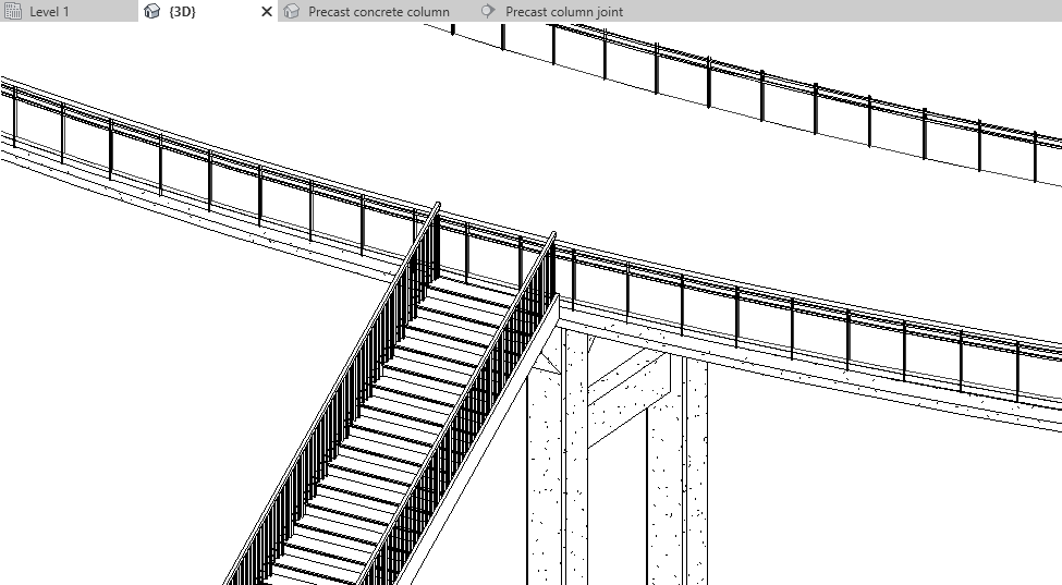

railing on bridge blocking the stair
Hi everyone, as you see in the picture, railing on the bridge is blocking the stair. How can I fix it? Could you please help me? Thank you.1.PNGThank you.
3 REPLIES 3
chughes
in reply to: Anonymous
chughes
You need 2 individual railings, ending on either side of the stair.
syman2000
syman2000
Select the railing on the bridge copy and paste it at the same place. Edit the railing and end it at one side of the stair. Then edit the copied railing and edit it and end it to another side of the stair.
 Just call it out as a gate...in the closed position.  And then call it a day and go drink a beer.  😉
