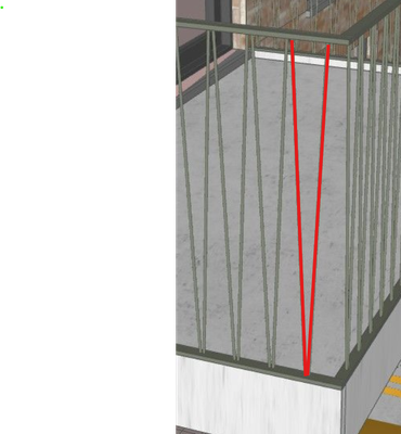

Hi, I am trying in Revit to create a railing with oblique baluster profiles like in the attached image.
I would be thankfull for a tip or a suggestion on how to make this type of railing in Revit, not only for a balcony but also for a stair, too.
Thank you!

RDAOU
@mihai.barbat5D59H
for the balcony bair each 2 in a baluster,. ie: model each baluster to look like a V
for the stair model each 3 bars as a baluster and configure the rail to use 1 Baluster per Tread
