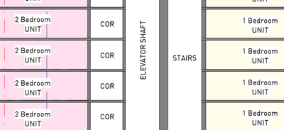

I have three buildings in separate files, and they are all linked onto one site file to create site plans, sections etc. while the rest of the team works on unit iterations. Currently I have the section set up in a very inefficient way where rooms are hatched in with a filled region (picture below). Since units are constantly changing, it would be great if these "hatches" are automated via volumes.
The issue arises where I am unable to view the volumes in section beyond a grey, un-editable box. I have attempted to go into a building file, toggle volume computation to "on", and then go back into the section file where the building is linked and toggle "Room Bounding" on. Rooms are able to be selected, but nothing further.

Thank you for your reply - this is what the properties look like when selected, I'm not sure how to progress from here

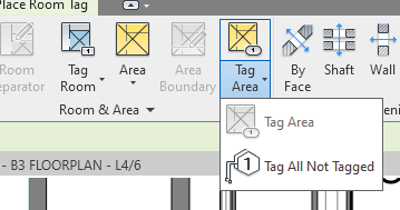

Yes, that appears to be the case! I suppose the question now is - how do I get colour schemes to show in section? (nice rhyme btw).  I'm able to tag rooms, not areas, but I assume that's not the solution as tagged rooms don't show colour. They also don't seem to reach the top of the ceiling……

Well, first off, Areas have no Volume. Second, you cannot change Link Rooms in the Parent Project. Third, set the Color Scheme to the one you want in the Section View Properties and then click Color Scheme on the Annotation Tab to place the Color Scheme in the Section View.
