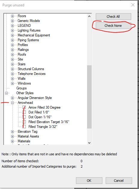

Revit doesn't allow purging everything.
hmunsell
  • Manage ribbon > Settings > Purge Unused
  • in the Purge unused window, pick the Check None option
  • scroll all the way tot he bottom and there should be an Arrowhead category
IF the arrowhead in question is truly not being used, it should be able to be purged from here.
