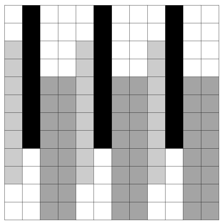

Can anyone help me make this .pat hatch?  I need one to have the tiles lay vertically and one with the tiles laying horizontally. mosaic tile.JPGC578295 (1).jpgC578295.jpgmosaic tile - Copy.JPG

Whats the scale of the grid? 1"?

yes, it is a 1" grid (so the entire grid shown is 1 sqft)

ellie7XSRV
I figured out my own question. I'll leave the post in case someone wants the same hatch.
Horizontal:
*Horizontal Mosaic Tile
;%TYPE=MODEL
0, 0, 0, 0, 2
0, 0, 3, 0, 4
90, 0, 0, 0, 8, 2, -2
90, 4, 2, 0, 8, 1, -3
90, 2, 3, 0, 8, 1, -3
Vertical:
*Vertical Mosaic Tile
;%TYPE=MODEL
90, 0, 0, 0, 2
90, 3, 0, 0, 4
0, 2, 4, 0, 8, 1, -3
0, 3, 2, 0, 8, 1, -3

You sure that is the grid layout you want? It doesn't match your material photos. And this layout is repeating at the double wide line... see below: (i made it 4" x 12" since it repeated 3x across, you don't need all that).

The grid does match the samples. You had an extra line in there somewhere. I figured it out. (see solution)

That's pretty much the perfect answer.

👍 These are much better than the grid you showed earlier. Good work.
