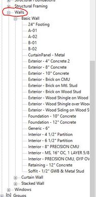

I try to train Revit with Youtube videos. But so many things don't work. Now I have a problem with the "Project Browser". When I click "Wall" in the Architect module, I only see a few lines of data, but not an icon for the wall. Like in the Youtube video. The videos of how I can manipulate the Project Browser are also unsatisfactory.
Does anyone have any idea.

scroll down to Families, pick the "+" . scroll down to Wall and select "+" again.

Looks to me like you closed your properties palette. Go to the view tab of the ribbon and all the way on the right select User Interface and use that drop down, Select Properties Palette there. That should bring it back. More than likely at some point you clicked the "x" on it an it closed. Happens all the time to my students in my Revit class. Don't click on "x's" if you are not sure what is going to happen.  😉

Loboarch. This is the solution. Thank you very much!!!!!!!! Problem solved.

I was not in the middle of a command. The solution was to go in the View tab totally right.
