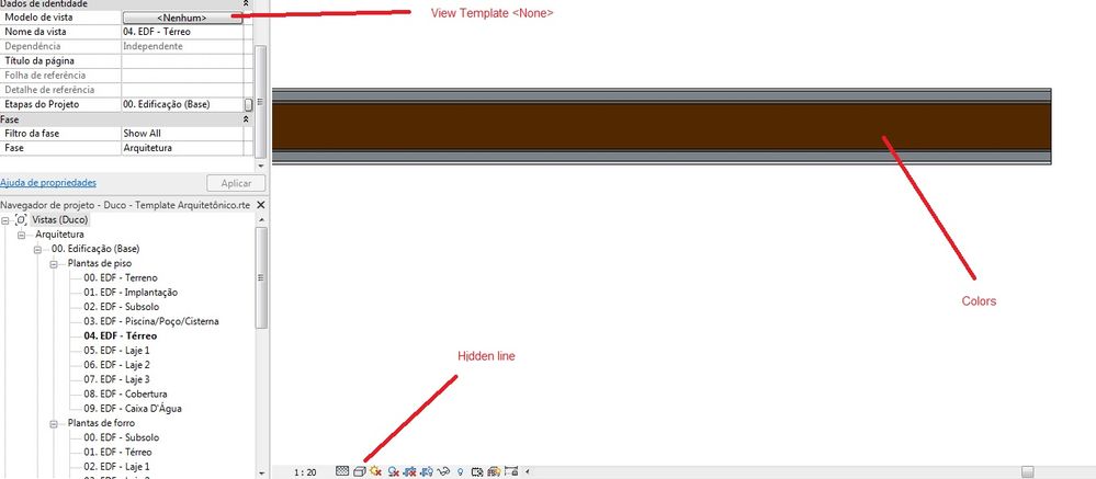

Im using Revit 2019, and in this (LOOONNNG) journey setting my own template i'm facing a problem that i couldn't find fix anywhere in internet.
In floor plans doesn't matter which visual style i choose, it always displays the same visual setting, and its not a view template issue cause i have none...
No matter if i select "Wireframe", nor "Hidden line",nor "Shaded", nor "Realistic" it seems to show "Consistent Colors" anyways.
If someone can, please help me with this.
Pictures attached (be aware that my Revit is in portuguese)

1. Check if there is a " FILTER " applied in the view
2. Create a brand new Floor plan, and see if the problem persist
3. in VG, Check Walls properties..
vg - wallvg - wall4. Check wall, right click, and override by element...
hope one of these should solve your problem.
Cheers
Corsten

None of those solved:
Overriding by element does nothing at all, creating a new floor plan the problem persists
Pictures:
No filters applied
Vg is alright

ennujozlagam
hello, try to install latest updates from autodesk or check your wall type cut pattern and see if helps. thanks
Changing the cut pattern from Solid fill to No patterns worked
I just wonder if its a revit 2019 issue, cause if i remember well when using revit 2013/14 the pattern wouldn't matter on wireframe style (i can be wrong).
I'd like to keep the cut pattern on color solid, and get the B&W on wireframe... is there a way to do so?
