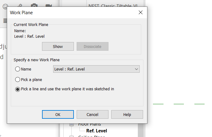

MetalFingerz
Hello @agnija.praskelevica ,
When it comes to hosting on a reference line, your nested family has to be face-based. As far as I know, making it workplane based will not work.
Then as @RDAOU said, when nesting the family you have to :
- edit its workplane
- pick a plane and click OK
- then hover on a reference line and tab it to select which plane of the line you want the nested family to be hosted on
- adjust the position of the nested family on the line
Capture d’écran 2021-09-15 à 17.59.14.pngCapture d’écran 2021-09-15 à 17.54.33.pngCapture d’écran 2021-09-15 à 17.54.42.pngCapture d’écran 2021-09-15 à 17.54.52.png

I try adjustable angle already 3 months, and not result. 😞
Your nested family CAN be a workplane based like what you already have.  You just need to move the light to the Level/Origin reference plane.  Then the rest of hosting it on a reference plane of of reference line (not the reference line itself) has already been explained multiple times.
