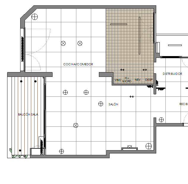

I'm having a different problem when plotting in the 2018. Here at the office we use 3 plans one over another to get de desired result, one in  hidden mode, other in the colr mode and other in the realist mode. when plotting in the 2017 the plot was fine, but now, in the 2018 Revit is changing the order of the plans Revit is putting the realist one under the others when it acctualy is the midle one.  in the monitor it seems fine, but once I make a pdf or plot directly to a plotter it changes the order! And in the plot preview too! Why? The WYSIWYG is not working anymore!

I have updated the Revit and the problem keep happening! And yes, I tried different pdf generators and even plotting direct to a ploter and the problems still happens! The problems can be seen in the plot preview, but when looking to the sheet in the monitor the draw seems fine, once in the plot preview and the order of the plans seem changed!

Can you share a screenshot, a recent journal, and Revit file? I can test your file and investigate further.

monitormonitorplot previewplot preview
Nachricht 9 von 14
als Antwort auf: Anonymous
The first image is a screen shot of the sheet and the second one is when doing a plot preview! In the inferior left corner of the plot preview screenshot you can see the realist under the colored.
I can send you the file if you give me a private link! But I think it is very easy to reproduce the error! if you put 2 plans one above other, putting the realistic one above, revit will send the realistic under when plotting! Anyway giveme a private link and I can send you this file! The same problem happens with differente files and it didn't happen in the 2017 version!
