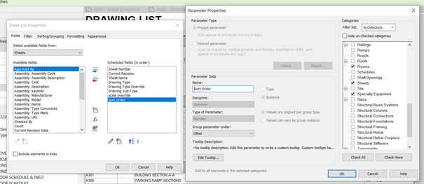

I use a different technique to fool the sheet list schedule to read GENERAL, DEMOLITION and ARCHITECTURE while the project browser has number prefix. It is difficult to achieve General since the browser is always sort by numeric or alphabet. To overcome this, I usually modify the schedule so it achieve what you want
First I would create a parameter call Sort Order and set it to number value
Here I would add calculated value and reference to sort order. Set it to text value and the formula I use would be if(Sort Order = 1, "GENERAL", if(Sort Order = 2, "DEMOLITION", if(Sort Order = 3, "ARCHITECTURE", "")))
For any sheet, you simply add those sheet to 1, 2 or 3 to get the header value.
In the sorting/grouping, I choose Sort Order first and follow by Drawing Type Override. Once you done this, the schedule will read GENERAL, DEMOLITION and ARCHITECTURE like the first screenshot.
