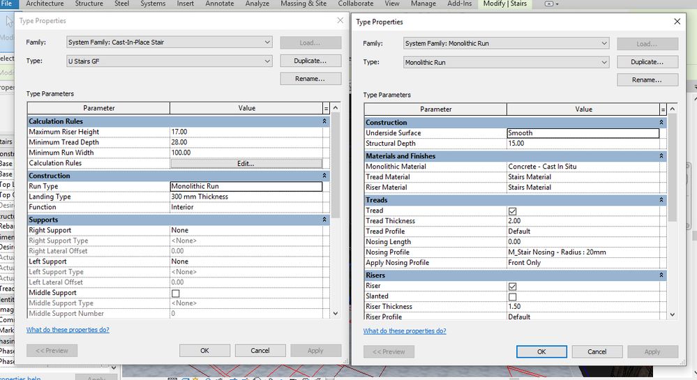

I'm sketching U shape stairs as 2 straight runs in addition to 1 arc shape run, the construction concrete is available only below the last run only. How to fix this problem.

Hi, I created stairs by sketch. The stairs made of construction concrete with treads and risers. The red arrow indicates that only the last part of the stairs has construction concrete when the other parts have only treads and risers. The problem is that there is no concrete when all these 3 parts of the stairs have the same properties and it's not related to a particular view or camera.

Turn off Riser.

Turn it off will show the concrete. But if I switch it on again the concrete disappears. In the end, I should turn it on for a material purpose.

It's FUBAR.  It should work with both Risers and Treads.  Just re-do it.
BTW: Yours works fine if I change the Riser Thickness. Go figure.
Nachricht 13 von 19
als Antwort auf: zs-17
Keep Riser on and change Nosing Length to at least equal to Riser thickness.

The riser thickness has no effect on my file. I will redo it later on and see if I can get a better result.

Just tried @ToanDN's suggestion. Works like a charm.

Yes this works

FWIW: Looks like you discovered a bone fide limitation.  This is a totally replicable phenom. Weird. But fun when you find 'em.  Now we need to find a workaround.  I mean, nosing is not acceptible to me personally.
