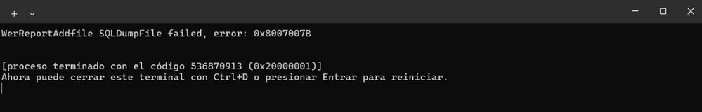

i have a problem opening revit, a powershell´s window keeps poping up, it opens and closes itself with the error code "0X8007007B". it only happens with revit, autocad works perfectly fine. i tried sfc /scannow but there´s nothing wrong.
full message:
WerReportAddfile SQLDumpFile failed, error: 0x8007007B
process ended code 536870913 (0x20000001)
i cant do anything cause it closes quick, i got this by filming it with my phone and slow motion.

Hi, The error code `0X8007007B` generally indicates an issue with a file path. Specifically, it usually means that an invalid or malformed path is being referenced. Happens due to incorrect environment variables, corrupted software installations, or registry errors.
Repair the installation
or
Reinstall Revit

i reinstalled three times already but it keeps happening 😞

Me pasa lo mismo, tengo version estudiante en revit 2023 con window 11, al abrir el archivo mientras carga, comienza a abrirse el power shell, y se abre y se cierra continuamente quedandose estancado asi. Imagen de WhatsApp 2024-09-05 a las 05.15.01_70feb413.jpg

I know this is an old thread, but I happened upon it while looking for a solution to this issue. The issue happened to my Revit 2022 after performing an in-place upgrade from Windows 10 > 11. The solution that worked for me was changing the drive sector size listed in https://www.autodesk.com/support/technical/article/caas/sfdcarticles/sfdcarticles/SQLDUMPER-EXE-wind...
Afterwards, if your event viewer throws up errors Event 512 SQLLocalDB 12.0, you can clear out GUID instances at HKEY_CURRENT_USER\Software\Microsoft\Microsoft SQL Server\UserInstances\{GUID}.
Perhaps this will help someone in the future.
