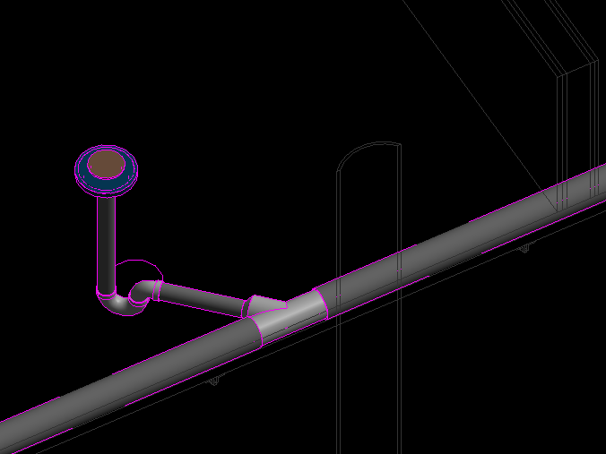

I am using Revit Architecture 2016 to place pipes in my building. I am running into a problem of my pipe fittings not showing in plan view. In plan view, where the pipe fittings should be is an empty space. I have looking into some settings and cannot figure out why they aren't showing up in plan view, HOWEVER, they are showing up in 3D view and in section! What gives??
Some things I looked into include:
- ensure element is not temporarily hidden or hidden in view.
- element is not being obscured by another element
- the category or subcategory is not hidden in view.
- the object is in view range
- the object is on the correct workset and the workset is loaded and visible in the view
- there is not graphic override on the elements
- in the pipe fitting family, the geomerty is set to an approriate detail level to show up in plan
- the object is not affected by a filter
If anyone has any ideas as to why these fittings aren't showing and how I can get them to show up I would be completely grateful.
I will attach some screen shots to show what is happening.

I have just encountered the same issue and it was down to Revit automatically assigning its own random system classification to the pipe fittings Smiley Sad
If you select the fitting in a 3D view (or any view that displays the fitting) then look in the properties you will see the system classification has unknowingly been assigned to hydronic (or some other classification), Just redraw the fitting on the domestic system classification and it will display in the plan view.

I found out that my pipe fittings weren't showing due to them being somehow assigned to a different System Classification that was turned off in filters.
Specifically, my pipe fittings (elbows, tees, etc.) on my Natural Gas piping were categorized as Domestic Hot Water in their System Classification and i had Domestic Hot Water turned off in my filters. Turning on Domestic Hot Water also turned on my pipe fittings for Natural Gas. From there, i disconnected and reconnected the natural gas line to the fitting and the System Classification changed and i was able to turn off Domestic Hot Water in my filters again and have my Natural Gas fittings still show up.
