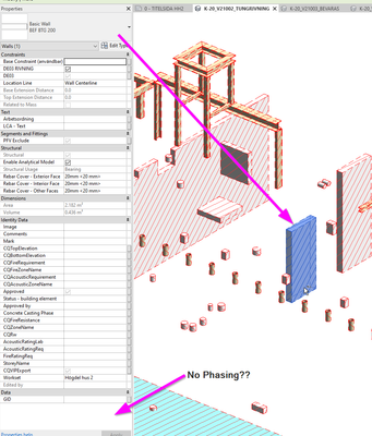

I'm having a problem with Demolish and phasing. I have some elements that are set to be "Demolish" but I cannot find the Phasing properties on the element? So I cannot change it. I want it to not be Demolished.
Any idea?
See pictures, here I am missing Phasing on that wall.
Another wall type have the phasing:

Try Cut or Copy/Paste the offending wall Aligned to Current View to reset Phase Properties.
Check if that wall is part of a Stacked Wall. If so, change the Stacked Wall Phase Properties to Existing and back to New.

Thanks, this is the thing. Did not know about infill.
