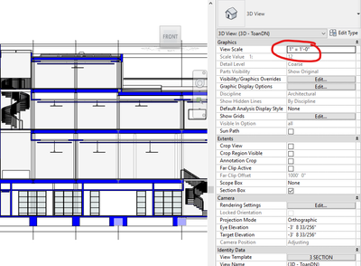

Do you have Silhouettes turned on?
Temporary change the Perspective to Orthographic, change the view scale, then change it back to Perspective.

@ToanDN
I doubt I would have ever figured this out! Thank you so much. Worked like a charm!
@lshannonEQEBT wrote:
@ToanDN
You can easily nail the issue down if you place the views on sheet prior to export.

isn't it a super strange behavior, that the line weights of the perspective view is influenced by the scale of the orthogonal view? Why is there a separate line weight settings dialog for perspective views? What is your best practice before changing from orthogonal to perspective? Change scale to 1:1 ?
