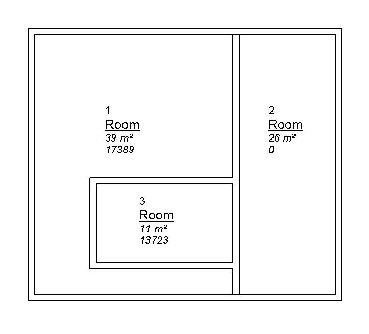

FaVarela
I'm affraid that I'm not allowed to share those models, but I replicate the same issue in new ones.
Here the linked one(COO):
And here the original one ARQ (exterior walls belong to a 3rd linked model LEV in this case)

FaVarela
That's right. Perimeter values from rooms located in ARQ, reading them from a linked model are obviously wrong.
As we can see, a perimeter value of 0mm it has to be wrong calculated.
