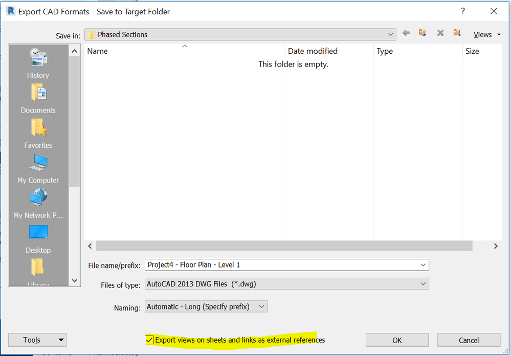

When exporting the components and any family of each revit floor to Autocad Separate blocks are formed.
AutoCAD file size rises.

Do you mean separate blocks or External References? You can uncheck the External References box.

Hello
Thank you for your reply
But this method does not solve the problem

each instance of the family (regardless of types) has its own ID number.
"door" has 12 types in Revit the model has 45 instances in the model it will create 45 blocks
Autocad does not breakdown this information, it simply creates another block.
now depending on how complex the family is will certainly create large file sizes when exported to AutoCAD.

Revit does this because each instance of a particular family type can have different properties.
You can replace the blocks in AutoCAD for cleaning up the files.

This would need an additional step - to go back to the example of 45 instances of doors - look at the doors, designate a block / blocks, and replace the others with it, then run a PURGE to delete the duplicates. Running OVERKILL after this step would also be helpful.

Here's literature I used to solve this inconvenience by using a LISP "BRE".
https://www.cadtutor.net/forum/topic/21571-replace-selected-block-or-blocks-with-another-block/
